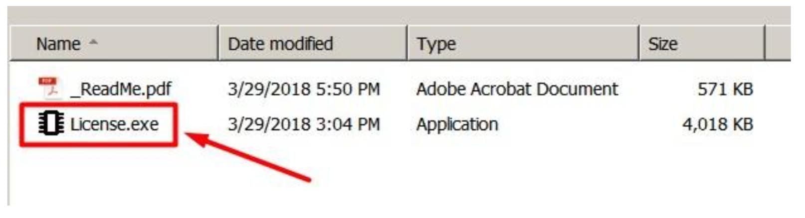

On Windows, download the Firmware, Manual PDF, and License.exe program from https://chiplesssolutions.com/download.shtml

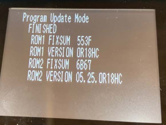

Boot the printer into "firmware update mode" (no ink cartridges are required in this step):
Make sure the printer is off.

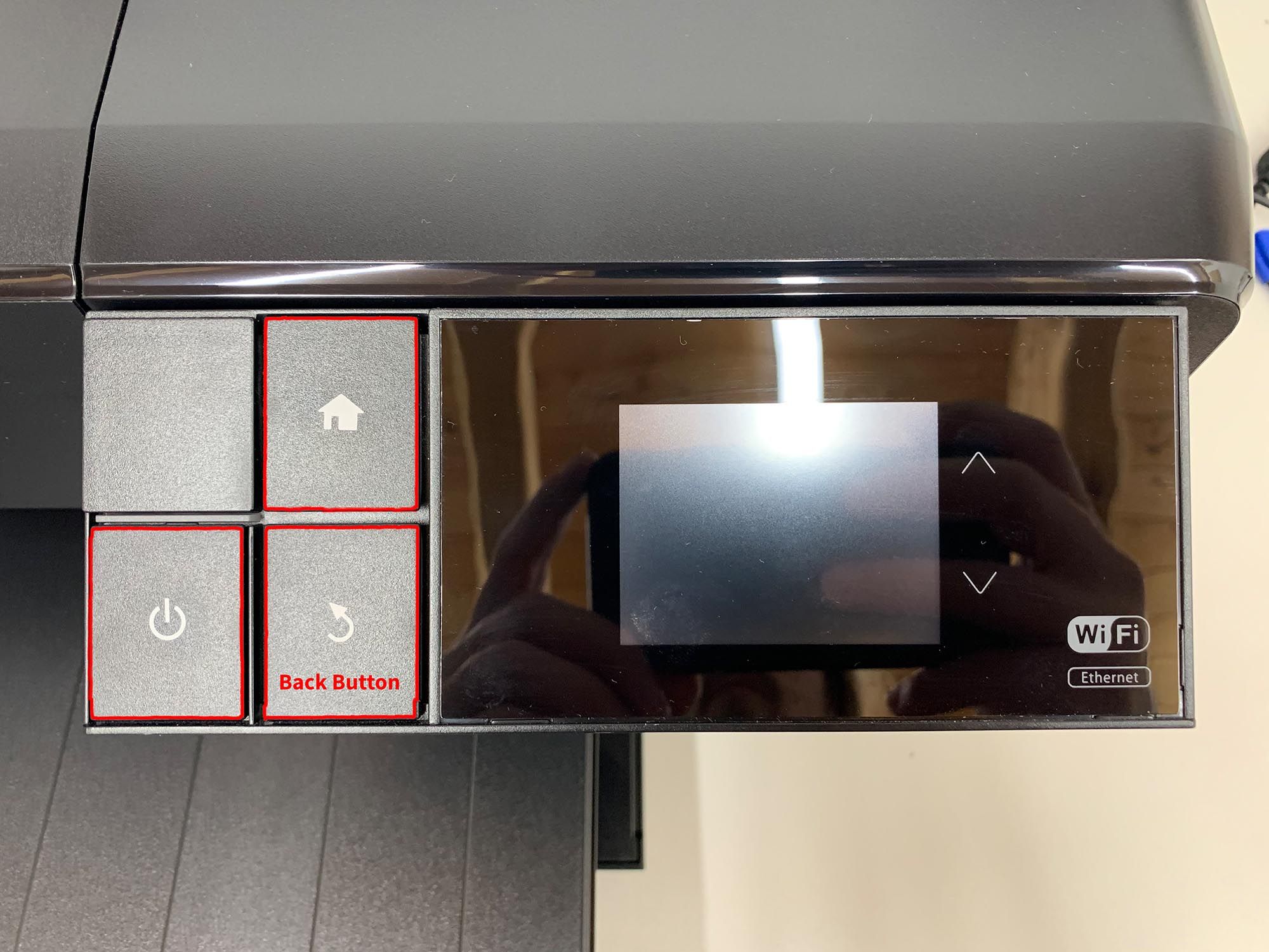

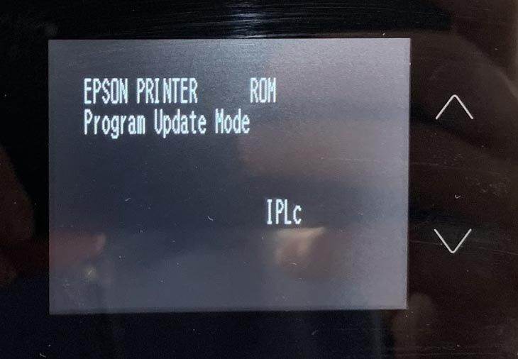

Press and Hold the following buttons for no less than 3 second and no more than 5 seconds: BACK + HOME + POWER and then release only the BACK button. Keep holding the Home and Power buttons. Eventually you will see white text and this means you are in Firmware Update Mode. If you see Red text it didn't work and you need to release all buttons, power off the printer, and try again. You can release the HOME and POWER buttons when that WHITE text appears.

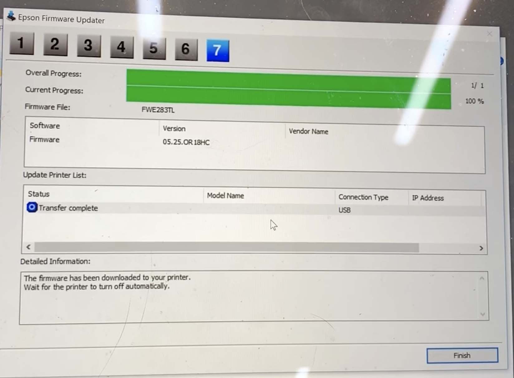

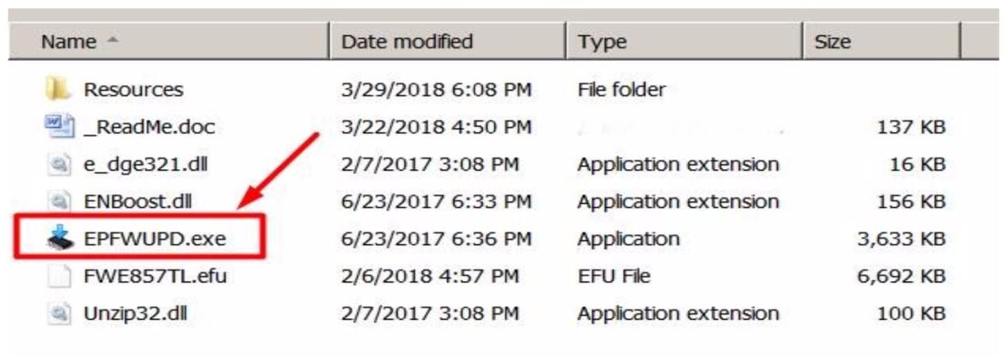

With the printer in Firmware Update Mode and plugged into your computer via USB, run the EPWUPD program to update the firmware on the printer.
This will take several minutes and the blue power light on the printer will be blinking the entire time. After several minutes (and well after it says "complete" on your computer) the printer will show the firmware version that you just installed. Verify that it's the same as the firmware as-shown on the EPWUPD program and then power off your printer.

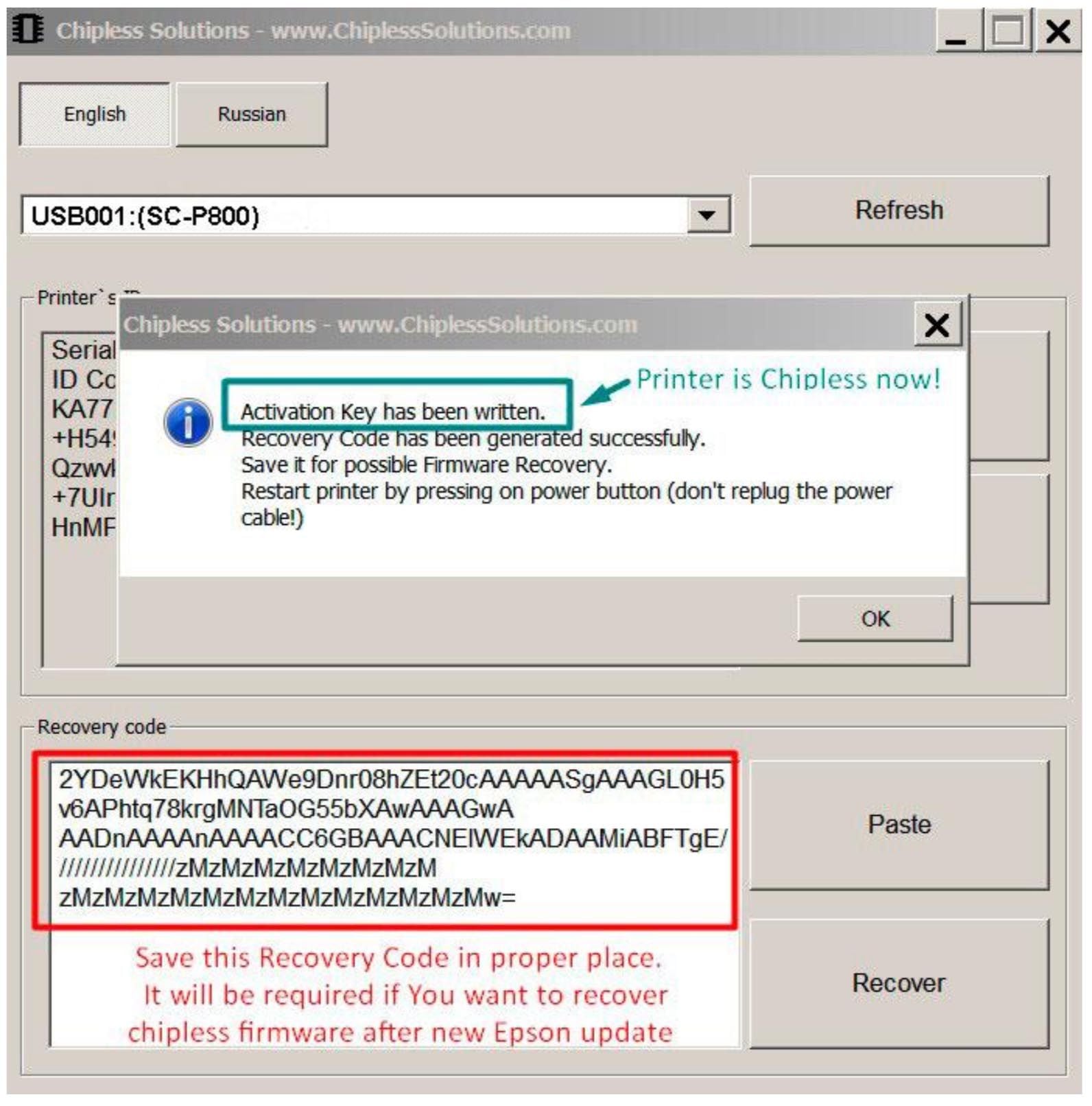

Run the License program.

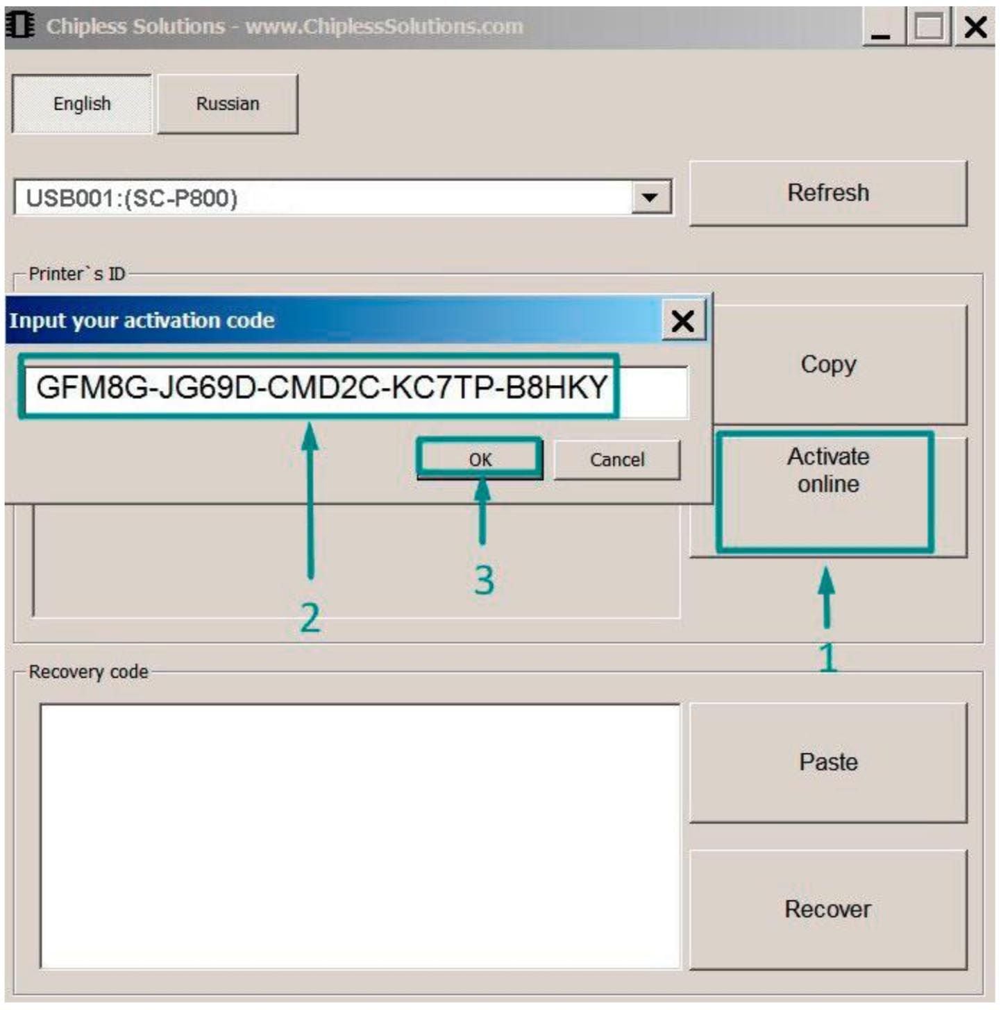

Select your Language. Select your Printer Model. Verify that the printer shows up in this program and then click on " Activate Online. "
Copy/Paste your license key. The software will then activate the chip-less firmware on your printer.
IMPORTANT: Copy/Paste and Save the "recovery code" that appears after the firmware is activated. You will need this if you ever need to re-install the chip-less firmware on this printer.

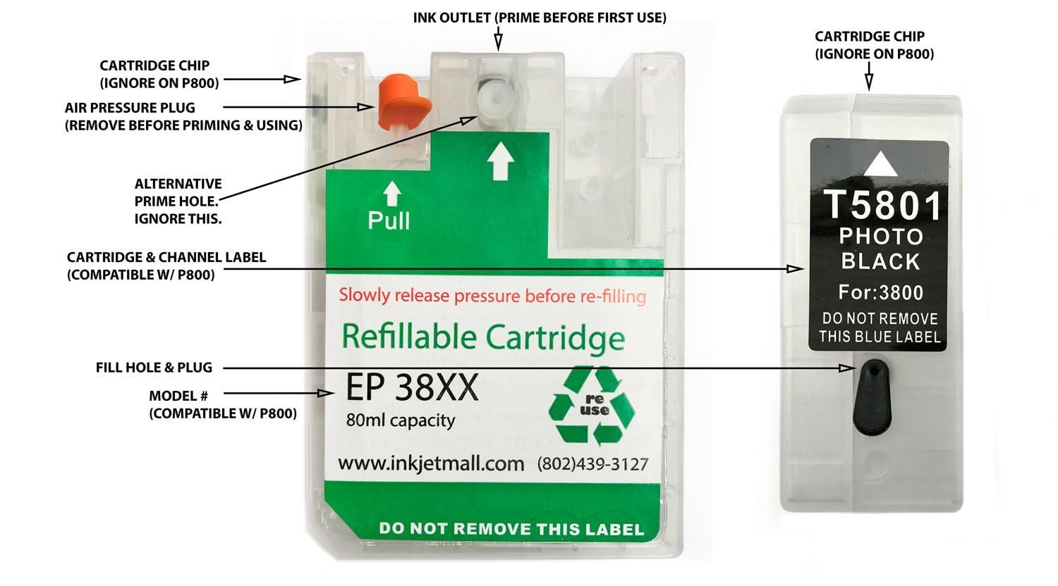

Before beginning, you should have one or more refillable carts, 60ml slip-tip syringe, blunt tip needle and plastic priming tip. Keep the 38xx control chips in the cartridge (even though they are not needed). If no chip is present, the cartridge can damage the sensor wires inside of the printe.
If this is a new P800 printer, please test your printer first! It is possible to receive a new printer that has one or more misfiring nozzles or some other defect. Make sure to run nozzle checks and perform some print tests to carefully examine print quality. Look for striations or thin lines in the images, which if all nozzles are firing, may indicate head alignment problems. This test will insure that you are installing the refillable carts in a printer which is in top working condition. Failure to test your printer first, may waste time and ink chasing down problems that are related to printer quality.
Filling cartridges with ink: Each cartridge has a colored rubber plug with pull tab on the back side- this is the ink fill hole. Place a cartridge upright with fill hole up, then remove the plug. Always shake ink bottles before filling or refilling cartridges to ensure pigment is in suspension for consistent output. Check to make sure the ink bottle and cartridge color position match before filling carts. Using a syringe with long blunt tip needle attached, draw 60ml of ink into the syringe and inject into the cartridge, then draw and inject another 10ml. (70ml fills the cartridge). Do NOT overfill cartridges. There MUST be a small air gap at the top of the cartridge for proper function.

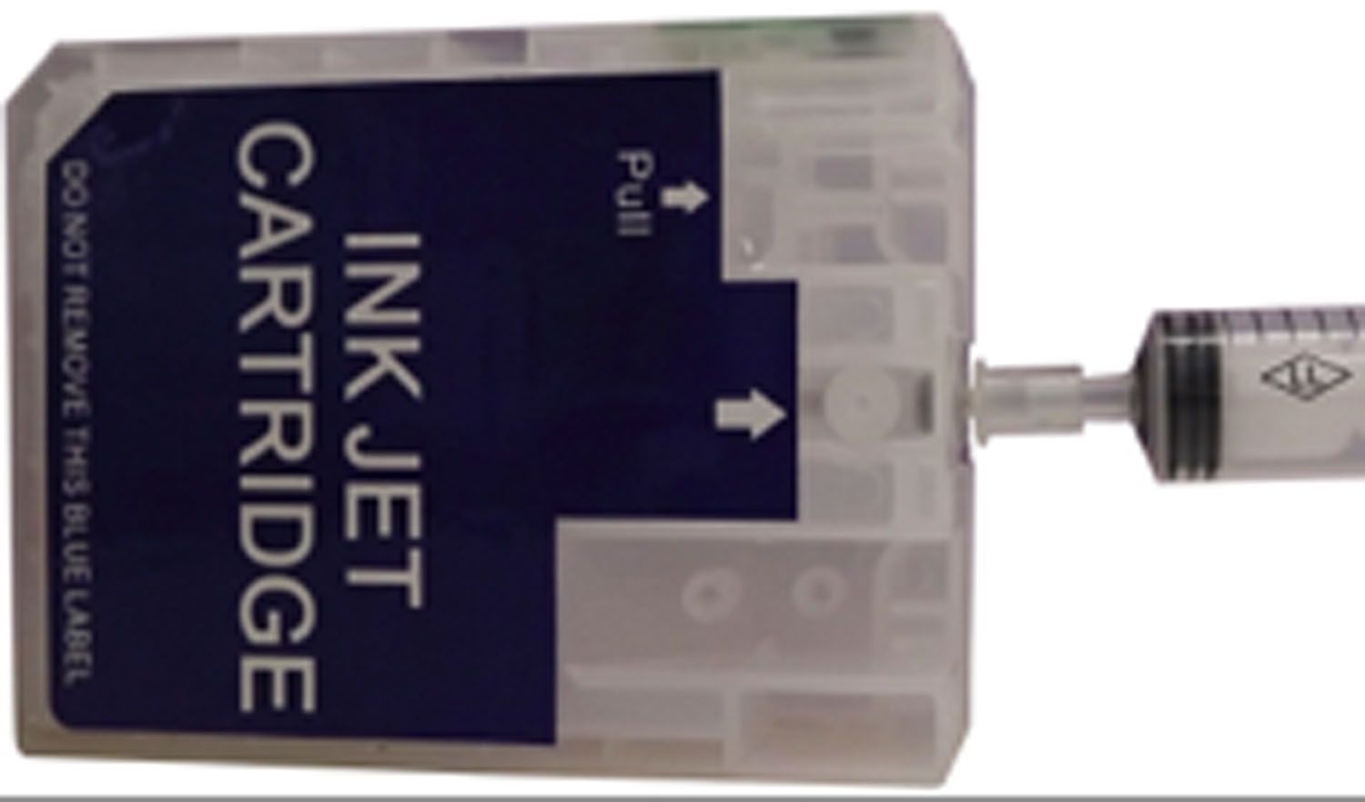

Prime cartridge with ink: After filling a cartridge with ink and reinserting the fill hole plug, place the cartridge upright as shown below. Remove the orange vent plug from the air inlet port if it is attached. With priming tip attached to the slip-tip syringe, insert the priming tip straight into the exit valve (ink outlet) to depress the spring and open the valve (the priming tip must be pushed thru the plastic membrane covering the exit valve- do NOT remove the plastic membrane). Pull the syringe plunger to fill the exit channel & valve until a few drops of ink enter the syringe (1mL to 2mL). When ink starts flowing into the syringe, pull the syringe and priming tip straight out of the cartridge. This will close and seal the exit valve. The cart is primed and ready to be installed into your printer. Syringes and blunt needles can be rinsed with distilled water and air dried for future use. Remember: If your cart has an orange plug over the air inlet point, REMOVE it before priming or installing the cartridge.

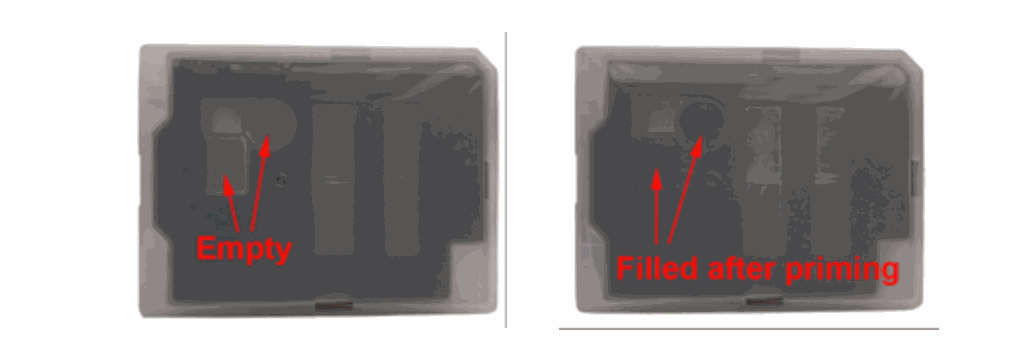

NOTE: Unprimed cartridges will not have ink in the exit channel, indicated by arrows in the photo below/left. The photo below/right shows a primed cartridge with ink in both chambers. The circle and rectangle chambers marked below MUST be at least 1/2 filled with ink for proper ink flow.
