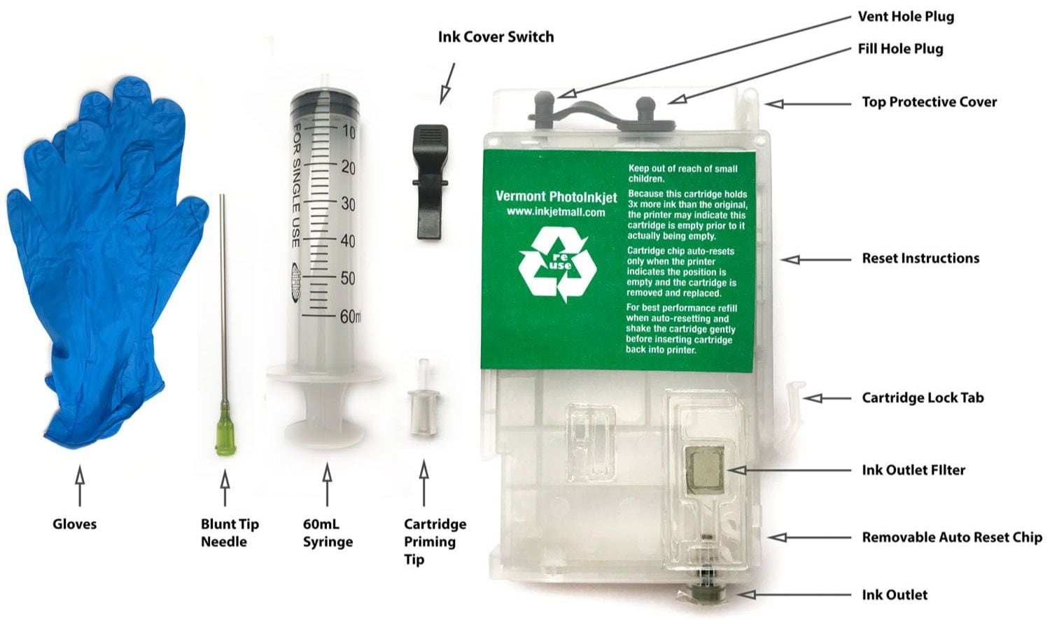

  1. Place the ink cartridge on a clean surface. Put on the rubber gloves. Take the correct bottle of ink (as noted by the cartridge label). Take out one syringe, one priming tip, and one blunt tip needle. Keep a roll of paper towel handy.
  2. Remove the orange lock protector. With the lock protector facing you, pull it horizontally to the left to remove it. Do not break the lock tab.
  3. Pop the top protective cover of the cartridge up, and pull out the Fill Hole Plug (keep the vent hole plug in).
  4. Place the blunt tip needle on the 60mL syringe.
  5. Unscrew the bottle top and then pull the vent nipple out. This can be difficult, so sometimes putting a bit of paper towel between your fingers to get a better grip on the vent nipple gives the leverage you need.
  6. Put the syringe with the blunt tip needle into the ink bottle and suck out 60mL of ink (or less if you want to do this in chunks.)
  7. Depress the 60mL of ink into the fill hole of the cartridge SLOWLY. If you see bubbles escaping change the position of the needle a bit.
  8. You do not have to fill the cartridge entirely. There should be a bit of room at the top of the cartridge. That is ok.
  9. Put the Cartridge Fill Hole plug back in and take out the vent hole plug.
  10. Tap the side of cartridge with your knuckle to release trapped air and allow ink to settle
  11. Remove the blunt tip needle from the syringe and put on a priming tip.
  12. Hold the cartridge roughly vertical (semi-horizontal is ok, upside down is not).
  13. With your other hand, insert the priming tip into the cartridge's Ink Outlet and suck out ink (about 1mL to 2mL worth). This will get rid of any air that is between the ink cartridge and ink outlet. Put the cartridge to the side and proceed to the next cartridge

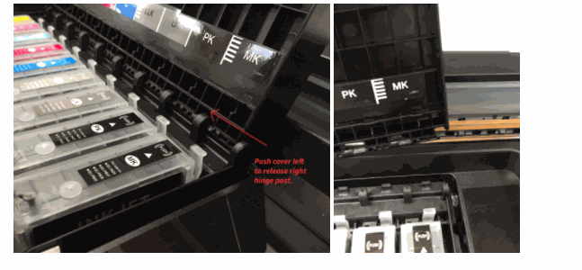

R3000 and P600 ink cover removal Ink Cover: Because these cartridges are over-sized, you must take off the ink cartridge cover. Swing it up, and pushing the cover left to release the right hinge. Then it will pop out. (It can be snapped right back in in the future if you are selling this machine). Note: It takes some force to get it out but it flexes enough to do it.

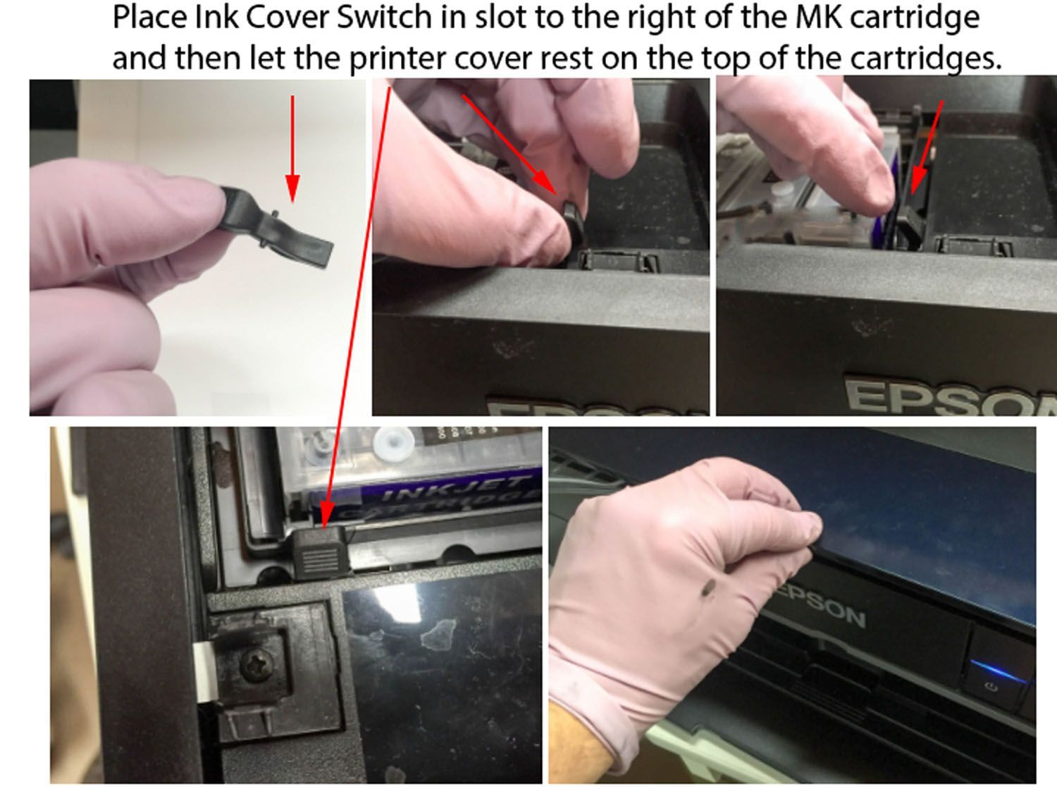

Ink Cover Switch: There is a small switch provided with your ink set or cartridge. It tricks the printer into thinking your ink cover is still down (even though it’s not even there). After installing the cartridges, place this switch into the correct slot as shown below. Note: Always take the switch OUT before doing anything with cartridges. Put the switch back after inserting your cartridge(s).
Ink Cover Switch Photo
Ink Cover Switch Photo 2 Printer Cover Switch:  There is a second small switch provided with your ink set or cartridge. This second switch tricks the printer into thinking the entire printer cover is still down. Put this switch deep into the middle slot of the printer (just to the right of the first switch) as shown on the right. It will lock into place. You can keep this switch in forever.

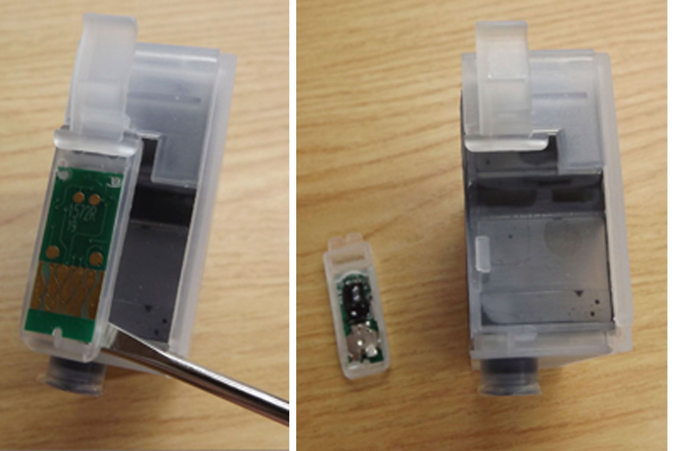

Replacing Chips:
Using a small straight edge screw driver, pry the old chip off the cartridge as shown below under the right/lower side, then slide the top of the chip out from under the cartridge locking tab (above the chip).

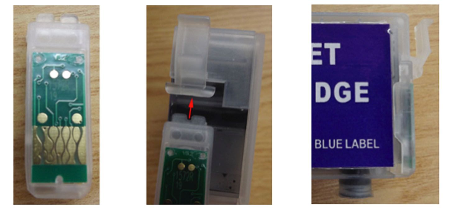

Chip Replacement
Note the plastic chip base has two prongs on top. To attach a new chip to the cartridge, slide these two tabs into the channels under the cartridge locking tab as shown below, then press the bottom of the chip onto the cartridge so it snaps into place and is flat on the cartridge.
