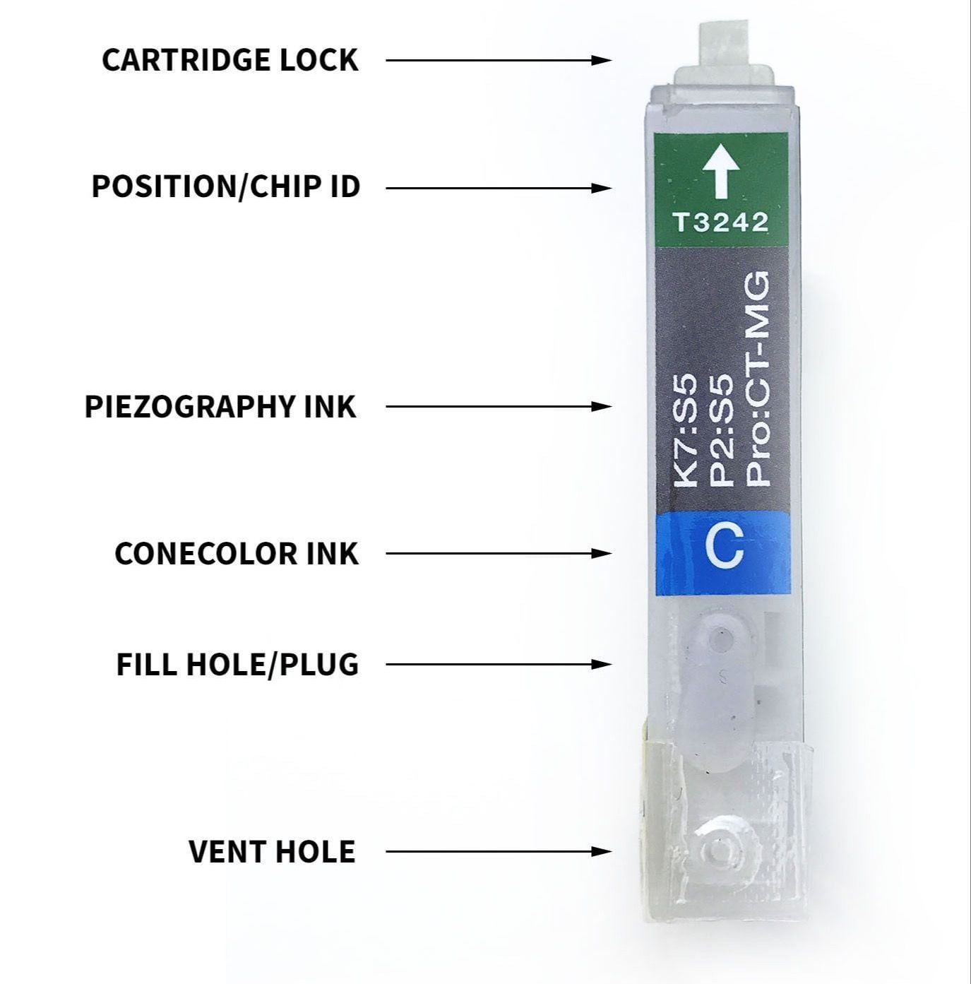

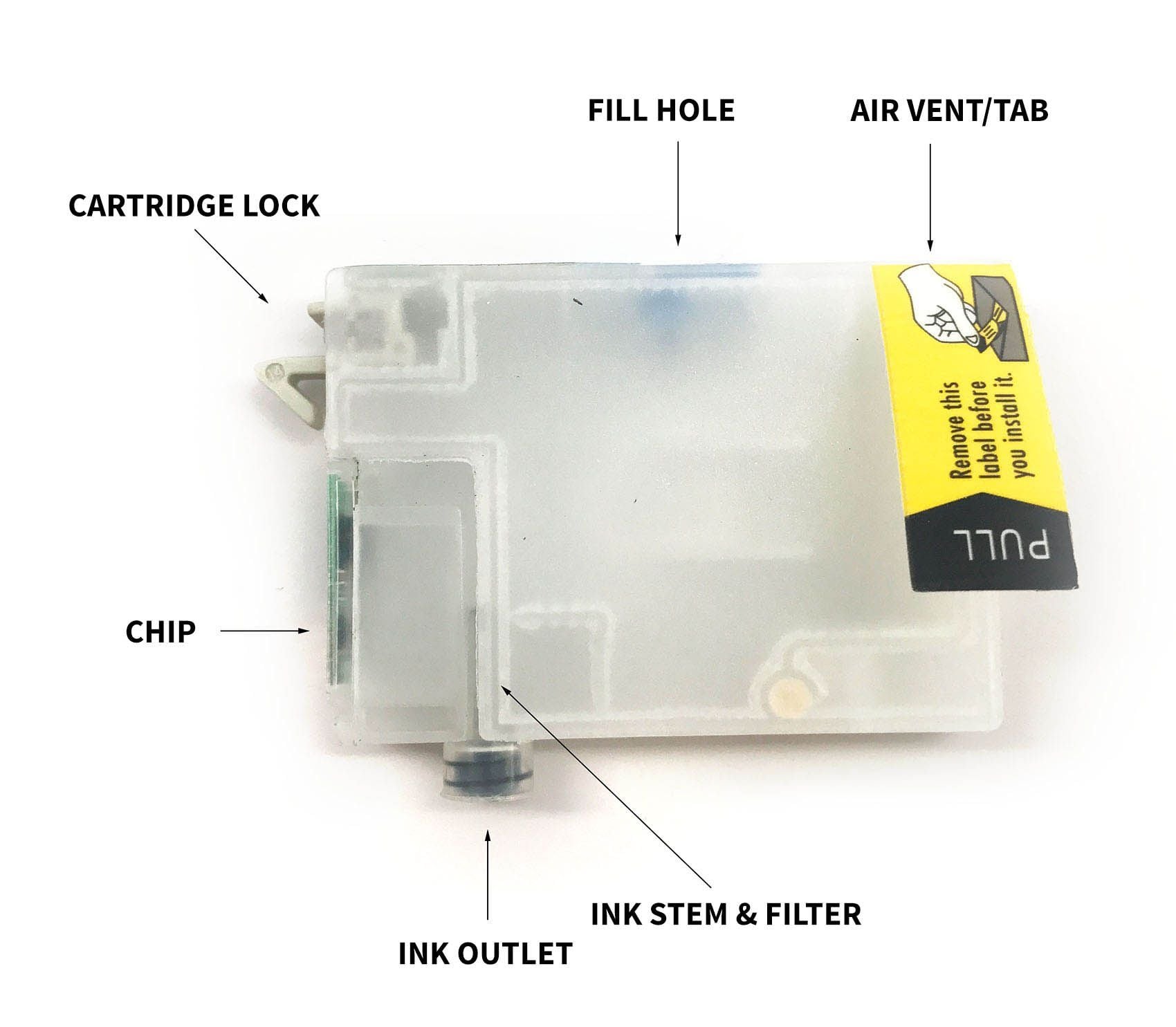

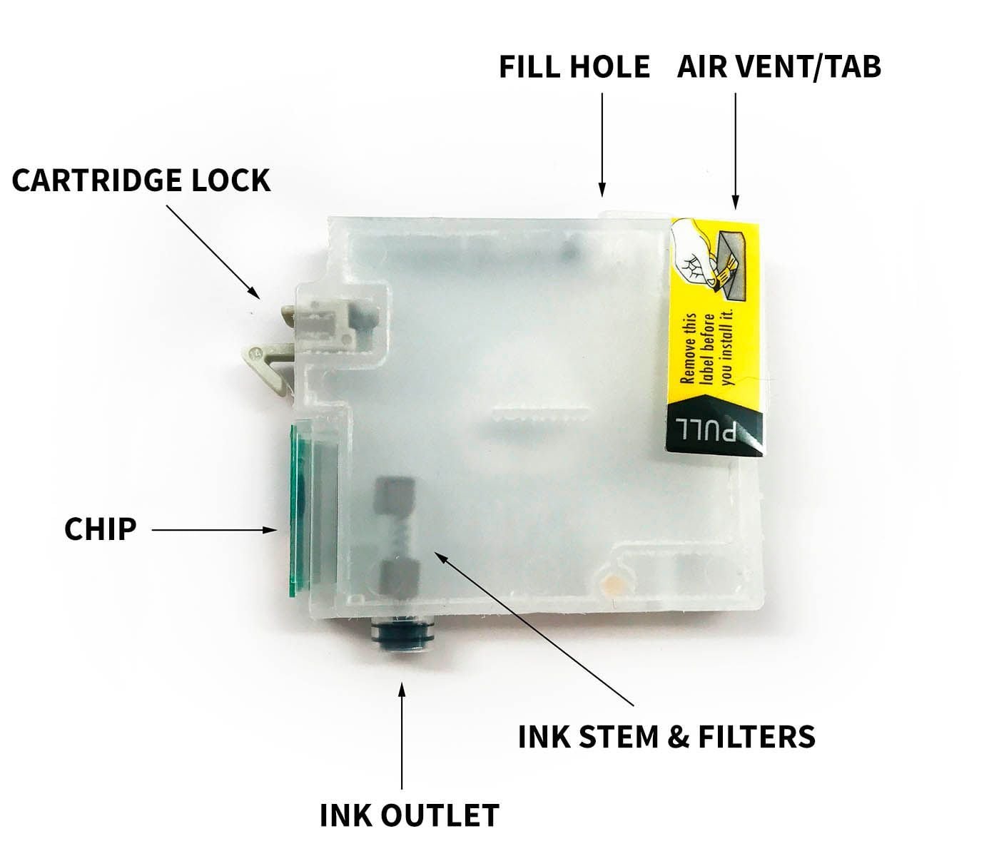

  4. Remove fill hole plug from top of cartridge. Keep the air vent tab (or plug) in!
  5. Leaving needle attached to syringe, insert needle into cartridge fill hole. Hold cartridge at an angle with fill hole up and ink outlet down, then gently push syringe plunger to slowly fill or refill cartridge with ink. Tap side of cartridge with your knuckle to release trapped air and allow ink to settle, then continue filling. Do this slowly.
  6. Once cartridge is filled with ink, remove needle from cartridge and insert rubber plug securely back into the fill hole. For accurate ink level tracking, cartridges must be almost totally filled (a small air bubble is ok, but too much air can cause the cart to empty before the printer gives warning).
  7. Gently tap filled cartridge a few times exit valve (cartridge outlet) down on a folded paper towel to force air up and ink down. Remove air vent plug/tab from the cartridge, making sure vent hole is fully OPEN. Do not remove top or side labels.

  1. Have ink, blunt needles and syringes ready on a workspace before removing carts from printer to refill.
  2. Remove colored plug from cartridge fill hole and leave air vent hole OPEN. Draw 15ml ink into the syringe. Leaving needle attached to syringe, insert needle tip into cartridge fill hole. Hold cartridge with fill hole up and ink outlet down then gently push syringe plunger to slowly refill cartridge with ink. Tap side of cartridge with your knuckle to release trapped air and allow ink to settle then continue filling. During this process you can place a finger over the vent hole or tape over it temporarily. This keep ink from entering the vent tab filter area. Make sure never to let your carts tip over during the refill process!
  3. Once cartridge is refilled with ink, remove needle and reinsert fill hole plug, then tap cart exit valve down on a folded paper towel a few times and reinstall into pinter. After installing refilled carts into the printer, wait 10-15 minutes for ink to settle. Always print a nozzle check after refilling carts before printing images.
