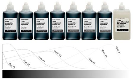

One of the benefits of the Piezography proprietary media profiles is to double the optical resolution of the converted Epson printer. They also produce more printable locations for microdots allowing a substantially smoother tonal lattitude. Combined with up to seven shades of carbon ink, these proprietary media profiles produce greater accuity and detail, smoother skin tones, increased shadow and highlight detail, and substantially more gray levels than the Epson ABW system. Piezography is the only system capable of printing tens of thousands of gray levels making it a perfect accompaniement to 16 bit raw photography.

We utilize more ink than Epson’s Advanced Black & White (ABW) process resulting in more substantive mid-tones and highlights. This is a distinction that separates Piezography from EPSON.  As an illustration, imagine overturning a crate of marbles. The majority of marbles will rest adjacent to the crate. The remainder would disperse in a random pattern with fewer marbles the further they traveled from the crate. This patterning is similar to Epson’s dither which is comprised of only three black inks. The Epson driver prints fewer of those “in between” dots of ink “tricking” the eye into seeing very light gray. In printing those highlights, Epson prints as little as 2 or 3 percent of total ink output.
In contrast, Piezography’s seven gradations of ink with proprietary media profiles, prints nearly 45% of total ink output in the highlights.  From the mid-tones to the blackest black, Piezography resolves levels of detail that escape the Epson system. Additional shades of ink in service of superior media profiles make a substantial difference when compared to Epson’s ABW output.

There are at least five ink sets available to choose from that are installed as an entire set of shades. The amount of shades differs depending upon printer model. These ink sets mimic traditional photography process.
