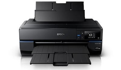

Epson SureColor P800. This is one of the best handling paper printers ever. Seems to just load everything without a complaint. We have run thousands of sheets through this model printer without head failure or damper failure (a problem of the previous generation the 3800/3880 models). In general we think this is one of the best printers in the 17″ class.
Epson 3800 / 3880. These two 17″ printers are for all practical purposes the same hardware. They are often both available in the Epson clearance center as a refurb from $749 to $949. This is one of the best handling paper printers ever. Seems to just load everything without a complaint. We have several of these printers at InkjetMall which we use for online printing services and all of our teaching workshops. Between the 3880s and 7880s, we handle 90% of the online print requests. With three 9880s we have it all covered. Pro printers are built exceptionally well. You do get what you pay for when it comes to the Pro line. For some people, printers work better than the newest P-series printers because they give you more control of platen gap and init-fill options. Over-all, these printers are a must-buy for long-term professional printing.
