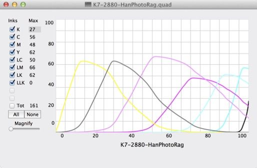

Let’s take a peak at a matte K7 curve:
The curves are actually represented by their color positions in the QuadTone RIP Curve View application.

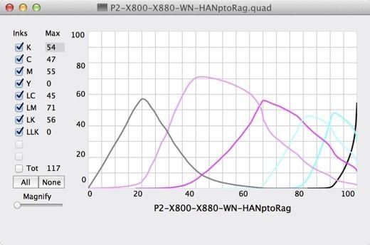

Now looking at a matte Piezography 2 curve:
The yellow curve is not represented in this Piezography 2 curve. There is no Shade 7 in Piezography 2. Instead, shade 7 is used for Photo Black. The above curve for Hahnemuhle Photo Rag has matte black in the black position.

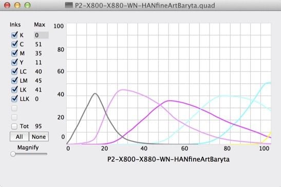

Let’s look at a glossy Piezography 2 curve next:
The Piezography 2 curve for Hahnemuhle Fine Art Baryta has photo black in the yellow position curve (far left).
