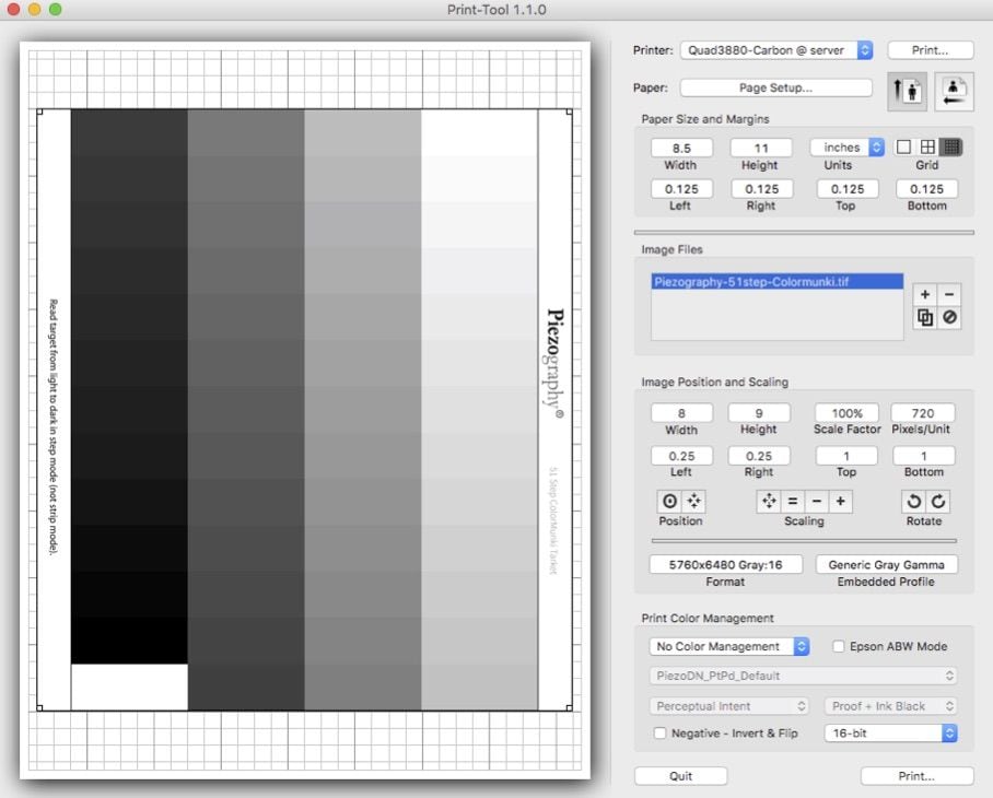

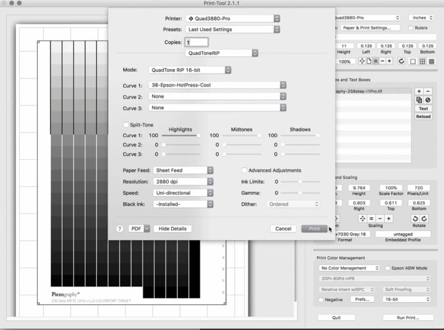

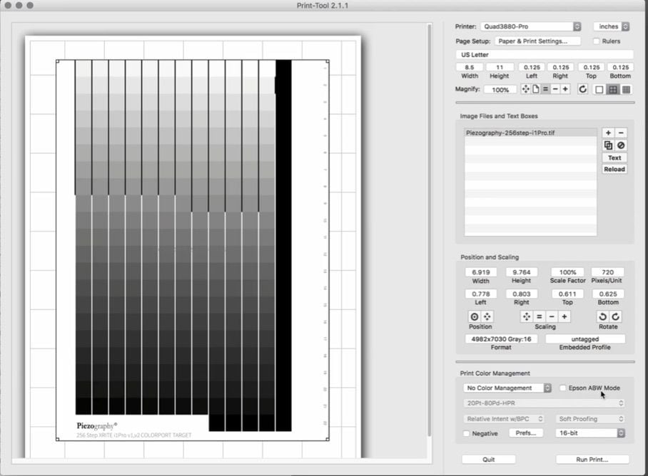

Open Print-Tool (or QTRgui if using PC), then open the correct 256step target “.tif” file. All of the target files are named with how many gray steps they have (256 in this case), and what device/software combination they are built for. For example, there’s a target built with 256 patches for the i1Pro2 device, using the ColorPort workflow, and it’s named: “Piezography-256step-i1Pro.tif” (shown in the Print Tool window), located in the ColorPort folder. Find your correct target. If you are confused by this please read the requirements.
Load a letter-size sheet of your desired paper into the printer (rolls work too), then set your page-setup and orientation correctly.
Select No Color Management and 16-bit at the bottom of the Print-Tool window. Push “print” and go to the QuadToneRIP menu item.
Select the curve that you want to linearize. The curve should be for a paper that is closest in quality (or equal) to the paper you are wanting to linearize . JonConeType2 is very close to Moab Entrada so this would be a good curve to start with when linearizing Moab Entrada if there isn’t already a Moab curve to work from. Make sure to print at 2880dpi (or 2880dpi super if available) and Uni-Directional to get the best quality!
Push “print” to print the target.

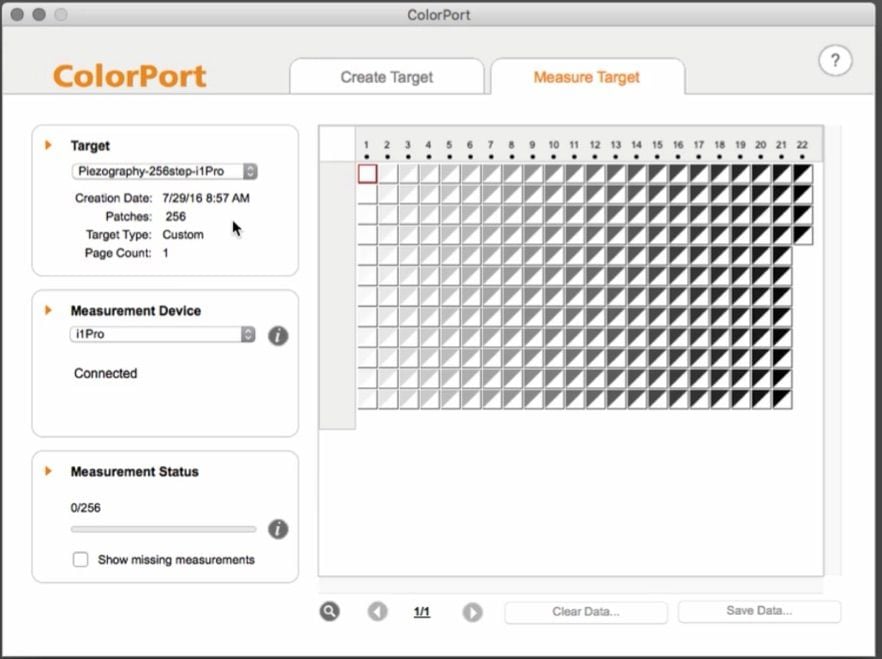

Once your target has been printed and cured overnight, plug in your i1Pro spectro and open the ColorPort software.

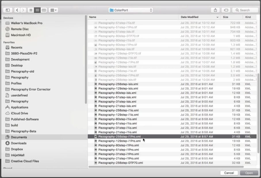

Import the ColorPort “xml” reference files for your printed target. This is done with “Target Manager”. The reference file has the exact same name as your printed target file, with a “.xml” at the end, and is saved in the same folder. If you don’t know how to use Target Manager in ColorPort, read the Xrite documentation. (You will be importing both the 256 step i1Pro xml target file into ColorPort.)

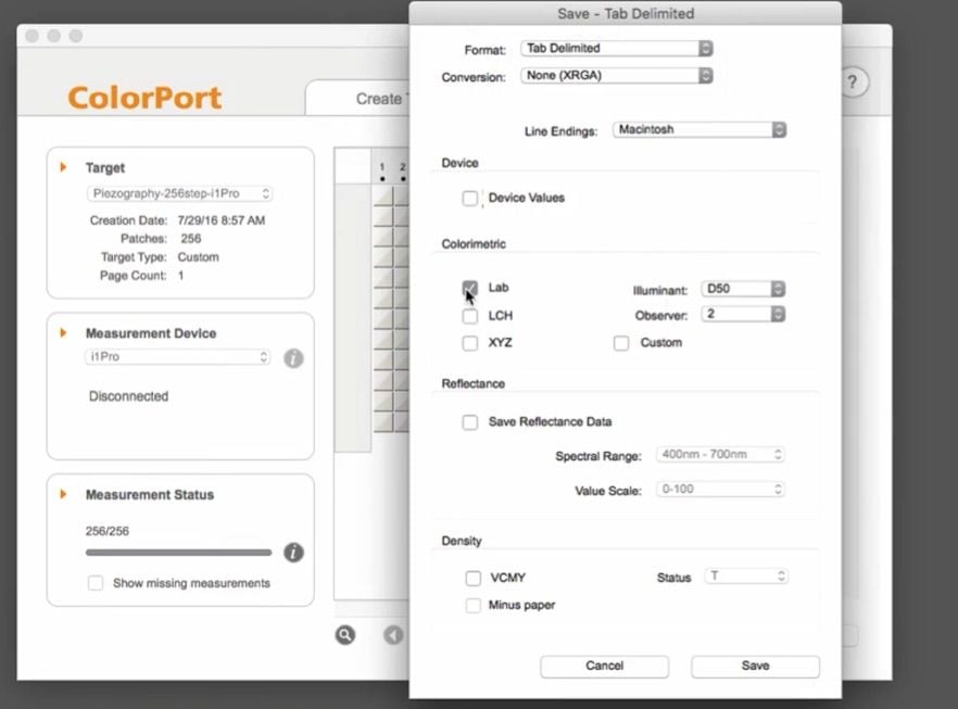

Once your device is plugged in, your reference file is selected, and you have white-calibrated your device for “strip” mode, go ahead and measure the target like you would any other target (spot mode takes longer than strip mode, but produces more accurate measurements, and therefore a better curve linearization).
After the target has been measured, click “Save Data”. Select “Tab Delimited” as the data format, and check the “Lab” check box on. Save the file to your desktop. This is a temporary txt file with just the L*a*b* numbers from the measurement.

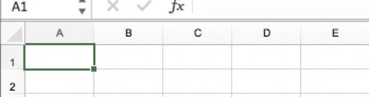

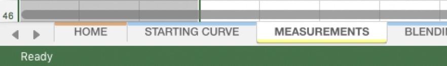

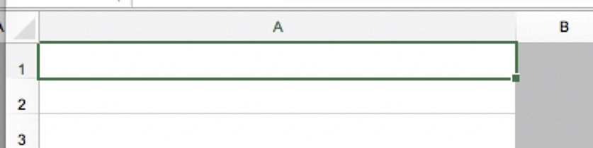

In Excel (Piezography Professional tool) go to the "MEASUREMENTS" sheet. Select all and Right-Click "Clear Contents". Then click A1 once.
Go Edit>Paste to paste the measurement data. The data will start in A1 and that first number will be the first LAB_L #.

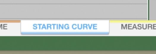

Go to the Piezography Professional Tool. Then go to "Starting Curve" and clear contents on all of A column (right click, clear contents). Click A1 once.
Edit>Paste. This will put the starting curve into the A1 column. Now click on the HOME sheet to go back home.

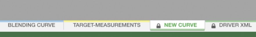

Go to "NEW CURVE" and then Edit>Copy.

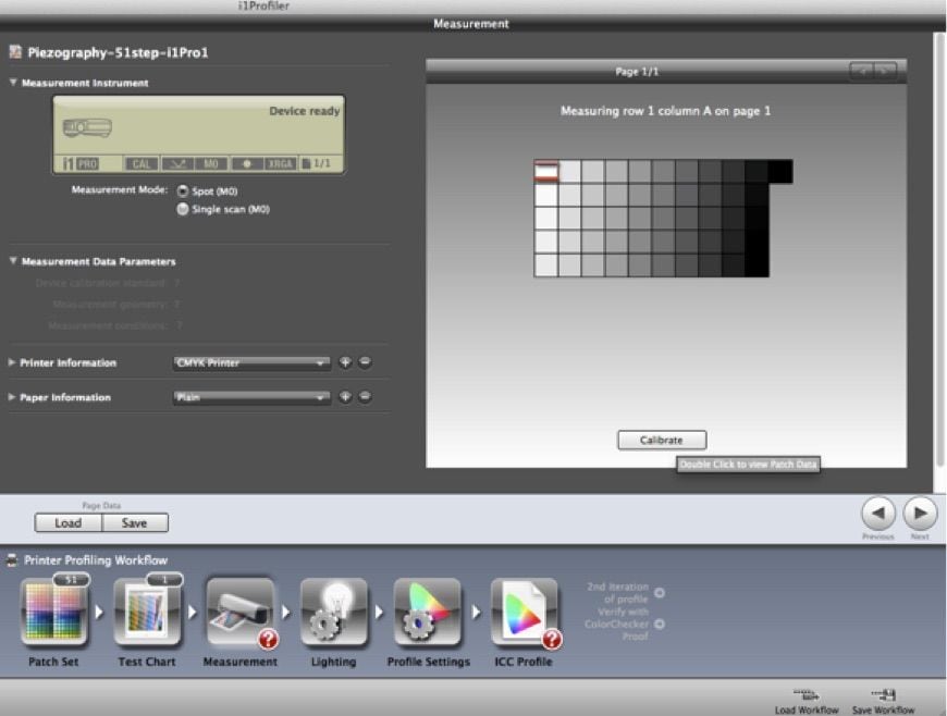

Once your target has been printed and cured overnight, plug in your i1Pro spectro and open the i1Profiler software.
Import the target reference files by clicking “Load Workflow” on the bottom/right corner. The reference file has the exact same name as your printed target file, with “.pwxf” at the end, and is saved in the same folder. If you don’t know how to use “Load Workflow” in i1Profiler, read the Xrite documentation. The screenshot is with the 51 step target (old workflow). But just import the 256 i1Profiler workflow as you follow along.
Once your device is plugged in, your reference file is selected, and you have white-calibrated your device for strip mode, go ahead and measure the target like you would any other target.

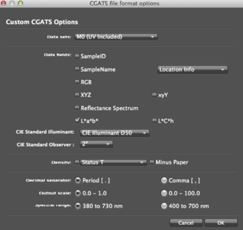

After the target has been measured, click “Save”. Select “M0 (UV Included)” as the data sets, then check the “L*a*b*” check box, and uncheck all other boxes. Save the file to your desktop. This is a temporary txt file with just the L*a*b* numbers from the measurement.
Open up this .txt file but instead of opening it inside of SublimeText, drag it over Excel. This will allow you to copy ONLY the LAB numbers under the LAB_L, LAB_A, and LAB_B column headers.
Paste these numbers in a new txt file, then select this txt and paste into the measurements sheet of the Piezography Professional XLSB tool just as written in the first section of this chapter (colorport). From this point on it’s the same workflow as the first section so continue there.

Open Print-Tool (or QTRgui if using PC), then open the correct 51step target “.tif” file. All of the target files are named with how many gray steps they have (51 or 129 step in this case), and what device/software combination they are built for. For example, there’s a target built with 51 (and 129) patches for the ColorMunki device, using the ColorPicker software, and it’s named: “Piezography-51step-Colormunki.tif” (shown in the Print Tool window, below), located in the ColorMunki folder. Find your correct target. If you are confused by this please read the requirements listed above.
Select the curve that you want to linearize. Make sure to print at 2880dpi and Uni-Directional to get the best quality!
