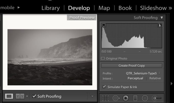

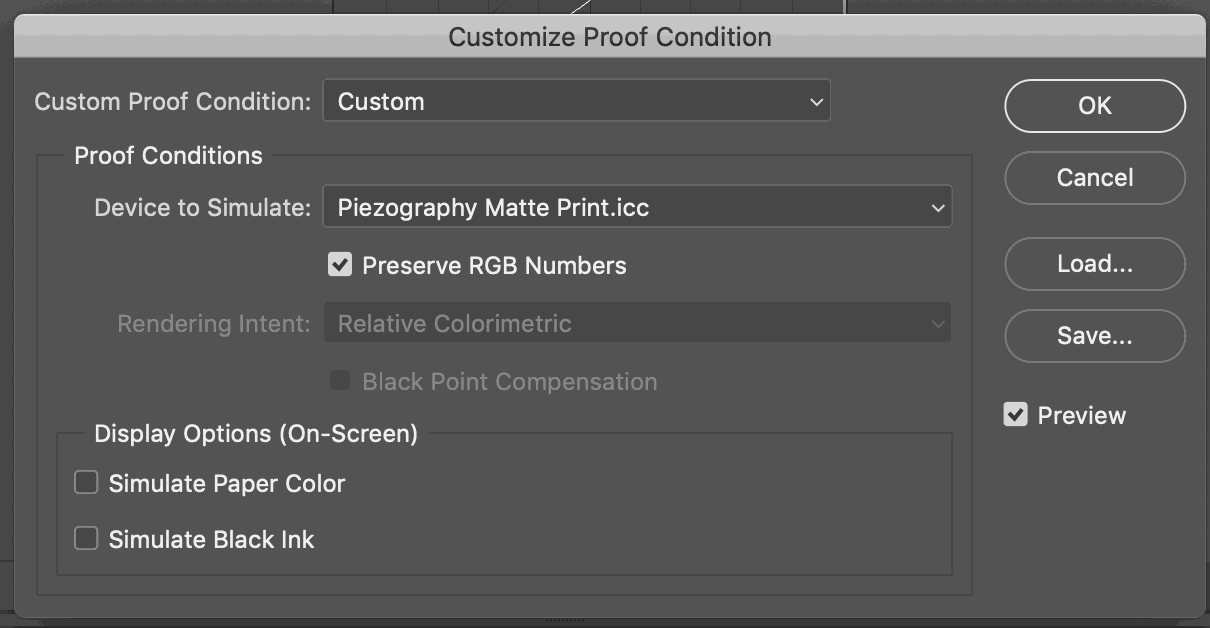

Soft Proof Profiles
asA soft proof profile is an ICC profile that is used to convert an image’s preview to that of what it would like if it were printed. This conversion takes place within the working space of Photoshop. Lightroom now allows previewing. Earlier when we setup Photoshop to the working spaces we selected (Gray Gamma 2.20 and Adobe RGB 1998). Photoshop uses these working spaces to convert the image on screen so that we can view them in relation to these working spaces. On top of this conversion, it is possible to have Photoshop and Lightroom further convert the image on the display to preview what it would look like printed by selecting a Soft Proof ICC profile.
Photoshop and Lightroom do this with Soft Proof function. The user selects an output ICC profile and the image is converted on screen. These output ICC profiles contain information such as the color of the paper. If the image is on a larger canvas, the Soft Proof will show the canvas in the color of the paper. Also, the black point (dMax or black ink) contains the luminosity value and the color of the actual printed dMax. And this is what usually stumps first time Soft Proof users. What happens is that exciting 4.0 dMax of the display is suddenly reduced to the 1.64 dMax of the paper. And yes you miss it when you look at your display - but you can not have it. Well, let’s say you can not print it. What you see with a Soft Proof is what you can print. And it takes some getting used to converting your sexy display into what looks like ink reflecting off paper.
Soft Proof Profiles are available in both Photoshop & Lightroom. Using them is predicated on nothing more than installing them into your operating system. Any output ICC profile can be used to preview an image.
However, the accuracy of the preview is directly related to the quality and accuracy of your display calibration. A Soft Proof ICC profile is no different than an output ICC profile. Output ICC profiles are created for the purpose of converting a file to the output space device so that it prints correctly (or as expected). That expectation is predicated on converting input pixels to output pixels. What you see on your display is not indicative of this process. The calibration of your display, if you wish to close this loop, depends solely on the quality and accuracy of your display calibration.
Piezography Soft Proof profiles however, are not really output ICC profiles. They are produced using the QTR Create ICC tool. They are used in conventional QTR workflow for purposes that can not be used in Piezography workflow. In Piezography, we use them solely as Soft Proof profiles.
