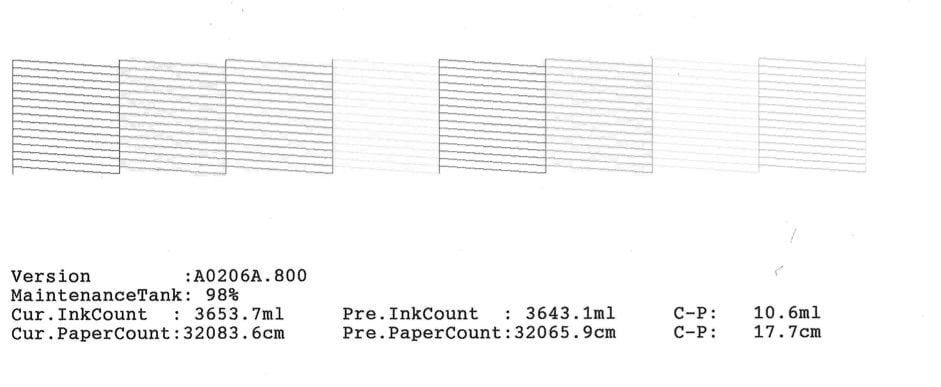

Nozzle check is the easiest procedure to run in order to determine if you have any printing condition that might waste an expensive sheet of paper. It takes less than a minute and can be done on inexpensive copy paper. You should not run the auto nozzle check, but rather the manual nozzle check. It produces a nozzle check that looks like this:
This simple test will tell you if you have a missing nozzle (will produce banding), have a missing ink (will look awful), have dirty nozzles (may produce banding or blobs). This is the stuff that ruins an expensive print. The print heads are affected by humidity, condition of the inks and dampers, and the cleanliness of the capping and cleaning station. We think that it’s a good idea to start the day off with a nozzle check and again every two hours or so. At some point you will get an idea of how often you can go without one.
One of the things that are most often overlooked is in reading the nozzle check itself. It is true that every single nozzle must print. There can be no gaps. However, a nozzle that prints below or above its step is the same if not worse than a missing nozzle. This particular jet will then overprint other dots and produce dark and light banding at the same time.
Each line represents a single nozzle. Each nozzle must print a line that subsequently steps down. Missing, or too low, or too high is all the same! The head needs cleaning! Do not attempt to make a print with a missing nozzle.
If you have recurrent missing nozzles - pay attention to your room humidity. 35% is minimum requirement to keep an Epson head moist.

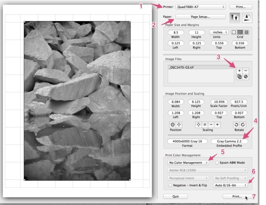

Launch Print-Tool if it is not already open.
Select available Quad printer from the Printer menu.
Select Paper Page Setup for the available Quad Printer.
Open an image/s and place or arrange on layout. You can drag or resize within the layout. Use the Position and Scaling and Rotate tools if desired.
Double triple check for the following Embedded Profiles: Gamma 2.2 or Adobe RGB (1998). If neither is present - do not proceed. You will need to reopen the image/s (check each) and convert and Save them with the correct Embedded Profile.
Double triple check that No Color Management is selected from the Print Color Management menu.
Choose Auto 8/16 bit from the Printer Color Management menu.

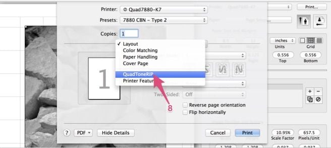

Click Print to print to the QuadTone RIP

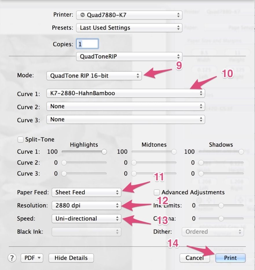

Select QuadToneRIP from the Layout menu.
Select QuadTone RIP 16-bit or 8-bit from Mode menu.
Select the correct Piezography Curve for the media you are printing (select “none” in the other two curve pull down lists)
Select the correct Paper Feed for the available Quad printer model.
Select 2880 dpi under the Resolution menu.
Select Uni-Directional for highest quality printing with the Speed menu.
Click Print to print. DO NOT TOUCH ADVANCED ADJUSTMENTS!

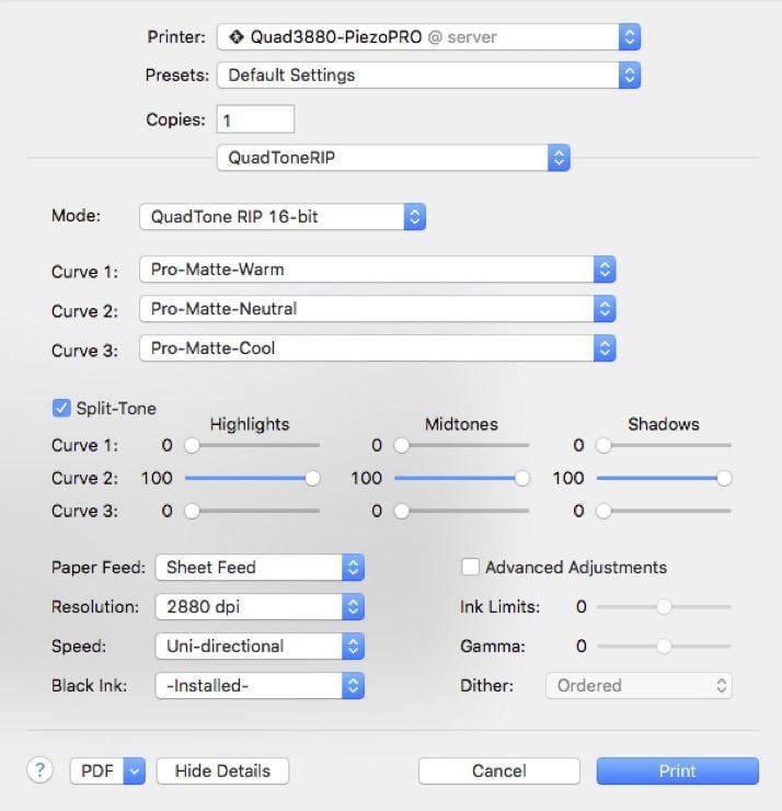

The beginning steps of printing with Piezography Pro are the same as with other all Piezography systems, but the difference is the curve selection in QuadTone RIP. Instead of selecting just one media curve as you do with Piezography K7/K6/P2, you select THREE curves with Piezography Pro, and use QTR sliders to blend the curves. For each paper, we provide three curves: Neutral, Warm and Cool.
First, select the “Warm”, “Cool” and “Neutral” curves for your media in the QTR curve pull down lists. Check “Split-Tone” to move the three sliders independently, otherwise the sliders will move together equally.
We recommend starting with a neutral base, by moving the curve slider that corresponds with the neutral curve to 100%, as shown below.

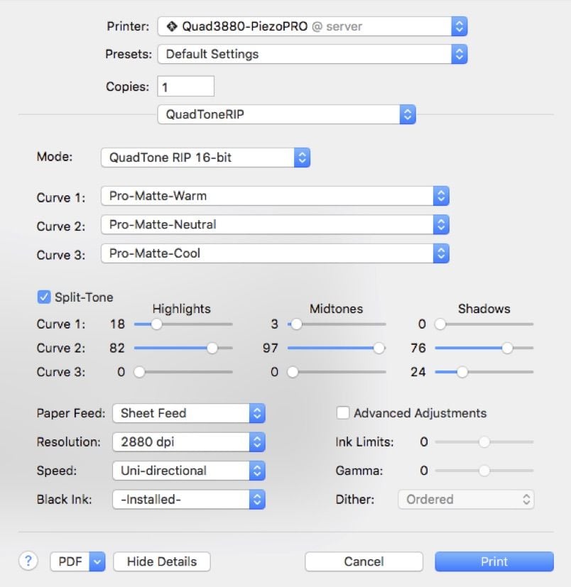

Now, add warm or cool tone by moving the curve sliders that correspond with the warm and cool curves, to add tone to the highlights, midtones and shadows. The possibilities are endless, and allow for the user to get a very wide range of tonal output with just one ink set.

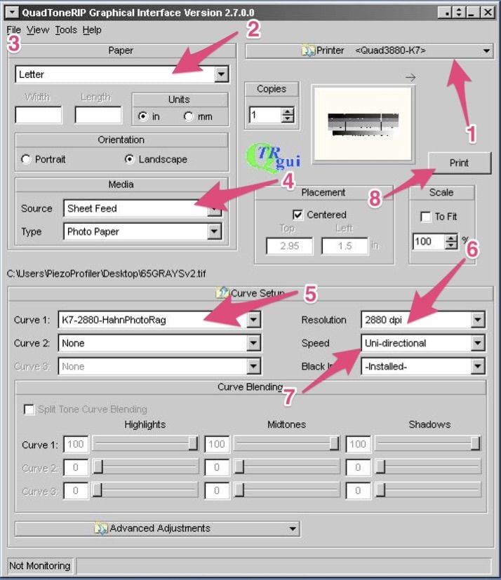

Windows Printing Cheat Sheet for K7/K6/P2

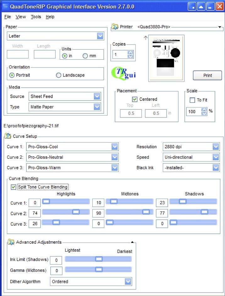

Launch QTRgui from the Start menu if it is not already open.
1. Select available Quad Printer from the Printer menu.
Windows Printing with Piezography PRO
